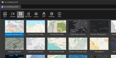

When I configure a scene in Unity using the ArcGIS Maps SDK for Unity, none on the services I add show.
I have configured a token, and I am able to choose a basemap (they are colored in the Map Creator). But none of the basemaps I select show at all. The only thing that happens is when viewing the scene (that is empty) the CPU is going up to 20-30% and staying there.

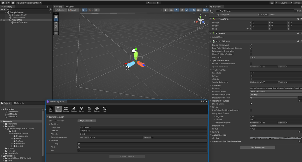

Thanks for showing the screenshot. The camera values looked correct. Could you also show another screenshot of the inspector window with ArcGISCamera game object being selected?
RobertEkroll
The ArcGISCamera in Inspector below. But I think that is OK - see text below image
Using Unity 2022.3.62 and SDK 2.2.0 - I also tried to create a new API token (I use the "new" developer portal - Location Platform). No luck, but I then tried to create an OAuth2 login, and when using the 2 hour temporary token, the selected basemap showed.
The API key have more privileges than the OAuth2. I have no layers except for basemap.
Do the API key need some special config?

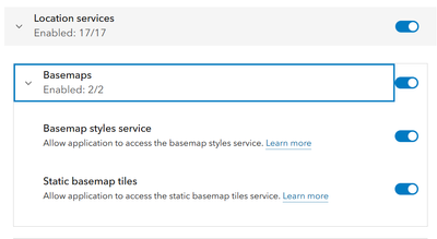

Could you check if the basemap service is on when you created an API key? It should be enabled by default though.
https://developers.arcgis.com/documentation/security-and-authentication/api-key-authentication/tutor...
RobertEkroll
All services are enabled
