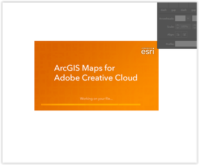

Perhaps related, perhaps not. I was unable to open any aix file if the Pro layout had halos in text elements. I tried uninstalling the extension as well as uninstalling AI and reinstalling different versions of each. Nothing worked until I removed all halos from text in ArcGIS Pro. AI just hung on the "working on your file" screen for ages until I forced it to close. I am aware that halos aren't supported in this workflow, but a more useful error message would be nice for troubleshooting. Or, even better, support halos in the Pro to AI workflow!
