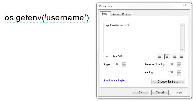

This isn't quite what I'm looking for. The username doesn't come in formatted correctly (for instance a user name is "johnd" but I want to display "John Doe") Can this be done using either the python dictionary sort of setup or by reading the dynamic text field?
Also, when I tried your python script, it just returned the script as text. Text Box.JPG
FC_Basson
MVP Alum
Ok, you're results are as expexted.  The Python code can't go in the dynamic text.  You will need to run it seperately or as a tool.  You can look at this post at StackOverflow that works for getting the full username.  It works well, so maybe you can run the code and write the username to the text box at startup if you are using a fixed layout template by creating a Add-in that runs at startup (ArcGIS Help 10.1).
