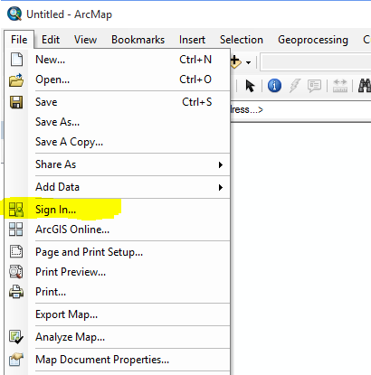

BradNiemand
Mark,
You would need to log in first for the ArcGIS World Geocoding Service to show up when using the Geocode Addresses tool.  This tool consumes credits when geocoding against the online service, because the results are stored, so it requires credentials in order for it to show up.
Close the tool and go to File > Sign In...
It will take a few seconds to log in and then you can reopen the Geocode Addresses tool and the ArcGIS World Geocoding Service will be in the dropdown now.
