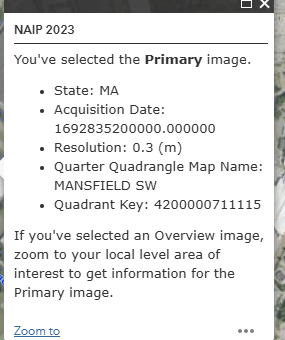

However, the Web App using my web map does NOT display the acquisition date as expected.  Instead, I get a numeric string:
You've selected the Primary image.
  • State: MA
  • Acquisition Date: 1692835200000.000000
  • Resolution: 0.3 (m)
  • Quarter Quadrangle Map Name: MANSFIELD SE
  • Quadrant Key: 4200000710730
If you've selected an Overview image, zoom to your local level area of interest to get information for the Primary image.

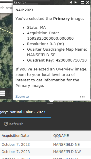

Yet, when I open the web app's attribute table, I do see the proper Acquisition Date.   Here is a screenshot with the popup result and attribute table result:
The popup text is simple enough:   Acquisition Date: {AcquisitionDate}
with default formatting:
The web map is used in a Web AppBuilder application configured with the Launchpad template.  The NAIP layer is set up with the subscriber content access to allow user access to this imagery.  The map/application is not public.
I tried a new map with just the NAIP layer, and a new app.   I get the same results.
