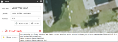

Hi, all.   I updated my Web Map to filter for NAIP YEAR = 2023 from YEAR = 2021.  Ultimately, I readded the USA NAIP Natural Color Imagery layer completely, filtered for YEAR = 2023.
USA NAIP Imagery: Natural Color is set up in my WAB (launchpad) with Subscriber Content Access.
The Print Widget uses the default service URL.
When I test Print Widget, I get:
"Failed to create layer from service at https://...../rest/services/NAIP/ImageServer"  as shown in the image below.
That is, if I have NAIP imagery turned on, printing to pdf fails.  If the layer is off, the pdf is created.

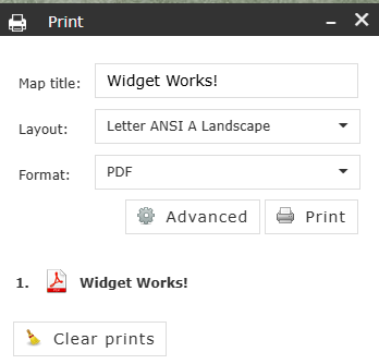

Hi.  My work around with Tech Support was to make a copy of the NAIP imagery with subscriber content access in my name (she was surprised my initial scenario had been working at all prior to this date).
Once I subbed in this version of the NAIP layer into the map and WAB, my print widget worked as expected.  I had to remember to go back and tweak other widgets in my app to allow for the new layer - easy enough.  Thanks for the help!

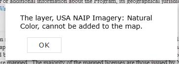

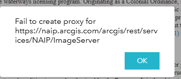

Morning, Lisa!   I thought I would post the latest twist in this adventure.   This morning upon opening my WAB application I got the following message.  Yesterday NAIP was displaying in the app.
It took me many iterations of back and forth-ing with test copies of the map and app to get rid of this message.  Some combination of deleting and re-adding the NAIP layer (did this more than once as it didn't initially work, so not sure of its role in final fix), PLUS resetting the Request Limit and Interval on the subscriber content access removed the above error message.   I was getting the proxy error many times as I experimented.
