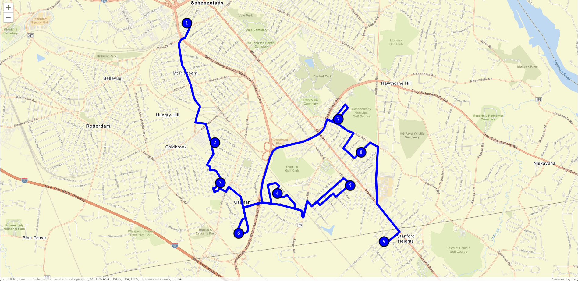

This is the original sequence stops and route.

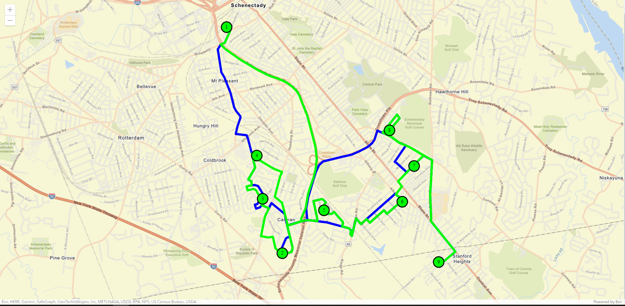

This green route is the response which findBestSequence is true.

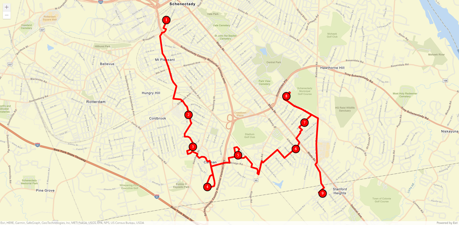

The red route is the expectation result.

As the document said, "As a result, the services revert to hierarchy if the straight-line distance between the stops is greater than 50 miles (80.46 kilometers), even if you have specified to find the route without using hierarchy."
reference
LeoDeng
One of the possible explanation I guess is that ArcGIS Online prefer useHierarchy.
However, when set the route parameters useHierarchy to false, the result is also incomprehensible for me.
