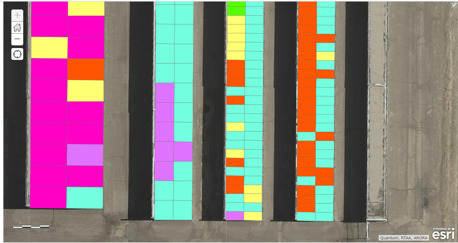

It appears that the features rendered in the WebView and MapView have a higher max allowable offset than the same features rendered in a web map in AGOL.  The 90 degree angles look good in the 2d api, but when they are drawn in 3d, they turn into non-90 degree angles.

The first image shows the polygons in a web map in AGOL
web map in AGOL

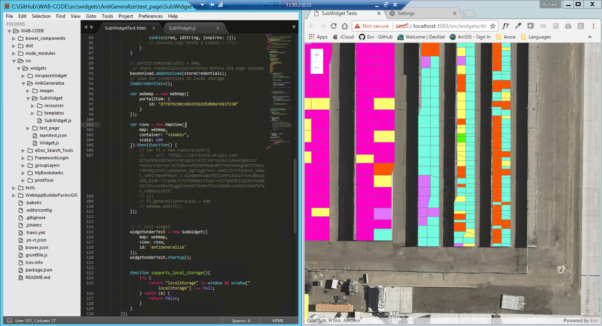

The second image show the same web map rendered in an Map View on my test connect web server.  As you can tell, there is a major issue happening somewhere
MapView of webmap

In the 3.x api the shapes are normal, but when I view them in the 4.x api they are modified.  Even if I use the MapView from the 4.x api.  So right now I don't know if the issue is the View on the Map or the layer in the map.

It looks to me like the data is generalized for display at a small scale and delivered to the client initially.  When I zoom in the geometries are not being redrawn with a less degree of generalization.
To be more precise, it is not appear to be generalizing vertices, just moving them based upon the scale and pixel size.

After reading more on the LayerView.  It seems that issue lies in there somewhere.  The default settings, whatever they may be is not delivering the correct data to the client when zooming in to large scales.  It is as if the geometry is being rendered like the camera is far away.

I can't replicate this issue, but to summarize what I understand the issue to be:
A large set of polygons viewed from a zoomed out perspective (notice the jagged edge of the polygons, presumably this is just due to pixel size):
Once I zoom in, the edges straighten:
If I take a screenshot right as I zoom in, I can see unstraightened edges before they're redrawn:
This seems to be more or less the issue here: that this process is not working for your geometries and (some) of your polygons are not being redrawn as you zoom in and out.
As to why that's happening, I'm still fairly clueless.  It could be a setting on your feature service I suppose, something like "maxAllowableOffset" as you mentioned.   So playing with that setting might be worthwhile, although you may have already tried that.
The fact that you mention this issue is worse for larger numbers of polygons makes me think that this may not be the issue though.  I'll keep playing around with this though.
