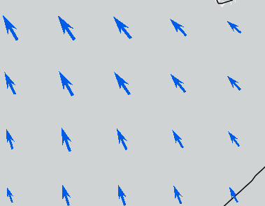

Hi all,
I am working with vector field data in ArcGIS Maps SDK for Javascript and I am wondering if you can change the color of the arrows. The documentation says that the styles are predefined so I am wondering if it is just not possible. Please see the below code. I put "color: "red" in everyplace I can think of but it does not seem to change the color.

Hi there,
It is not possible to change the color of the vector field renderer symbols at this time. We have plans to add support for this but I do not know when it will happen.

Thank you for your reply. I am mapping ocean currents (m/s) and wind stress (N/m²), but the current setup doesn't allow me to adjust the minimum and maximum values on any of the predesigned displays, which forces me to use the single-arrow symbology, resulting in wind stress and ocean currents being displayed in the same color. The inability to differentiate between the two layers is problematic. Adding this functionality feels like a straightforward enhancement. I hope ESRI adds support for it soon.
