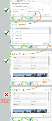

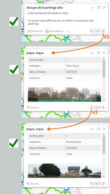

OlivierLefevre
Hi,
I've been trying to mix two functionnalities. One is about displaying attached images in popup. And the other is about clustering.
Most of the code below behaves as expected except for browsing cluster's features.

                    view.on("click", function(event) {
                        const opts = {
                            include: webmapOperationalLayers.filter(layer => {
                                return layer.type === "feature"
                        view.hitTest(event, opts)
                        .then(function (response) {
                            if (response.results.length) {
                                let graphic = response.results[0].graphic;
                                if (!graphic.attributes.objectid) {
                                    return;
                                buildLayerPopupTemplate(graphic.attributes.objectid, graphic.layer);
                        .catch(function(error) {
                            console.log(error)

                    view.popup.on("trigger-action", (event) => {
                        clearViewGraphics();
                        const id = event.action.id;
                        if (id === "convex-hull") {
                          displayConvexHull(view.popup.selectedFeature);
                        if (id === "show-features") {
                          displayFeatures(view.popup.selectedFeature);
                    reactiveUtils.watch(
                        () => [view.scale, view.popup.selectedFeature, view.popup.visible],
                        ([scale, selectedFeature, visible]) => {
                            clearViewGraphics()
                            if (selectedFeature) {
                                if (!selectedFeature.isAggregate) {
                                    buildLayerPopupTemplate(selectedFeature.attributes.objectid, selectedFeature.layer);

When browsing clicked features (forward and backward) everything is fine.
browsing clicked featuresbrowsing clicked features
Browsing forward cluster's features is fine too. But an error occurs when browsing those features backward.
browsing cluster's featuresbrowsing cluster's features
At line 355 selectedFeature.layer is null.
I don't understand why and how to fix this issue.
Could you please help me ?

This is a bug in the API, particularly the PopupViewModel, which I'll try to summarize here, and then provide recommendations.
Basically, the PopupViewModel stores a reference to all the features in the vicinity that you clicked on the map.  When clicking on a cluster, you can browse the cluster's features as shown in your screenshots.  When you click the next button, it takes that corresponding feature's Graphic reference and adds it to the MapView's graphics collection, thus enabling you to temporarily see that particular feature on the map (i.e. in addition to the cluster graphic).  If you click next again, it removes the current Graphic, and then adds the newly selected feature's Graphic.  It is this adding and removing from the MapView's graphics that causes the Graphics' layer property to get severed.
My recommendation for you:
There are various ways to work around this,, and all will fall under the category of a hack.  My recommendation is to apply the simplest one, and replace the reference to "layer" with the undocumented property "sourceLayer" like so:
buildLayerPopupTemplate(selectedFeature.attributes.objectid, selectedFeature.sourceLayer);
You can change this back if it ever gets fixed.

I just tried your hack @JoelBennett and it works pretty well.
Thank you very much for your help.
