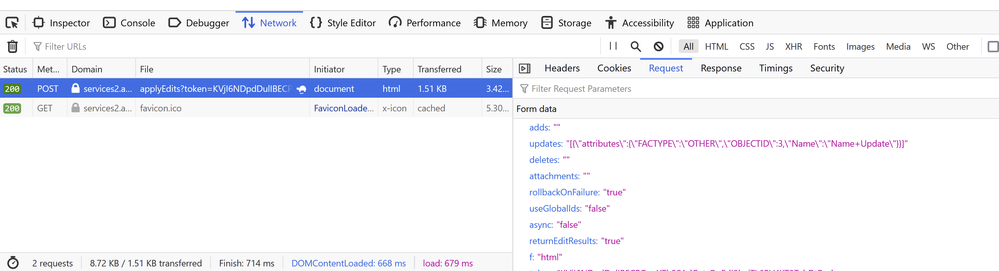

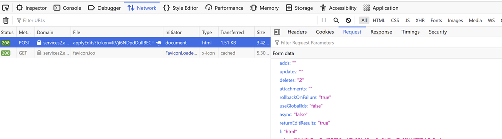

Can you post the entire chunk of code for making your edits?
I am able to successfully update and delete a record using the following payloads.

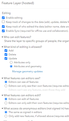

I am able to add just fine but when I click on Select under Edit Features, I am unable to make a selection.
These are my settings on the hosted feature layer which contains 4 separate layers.
