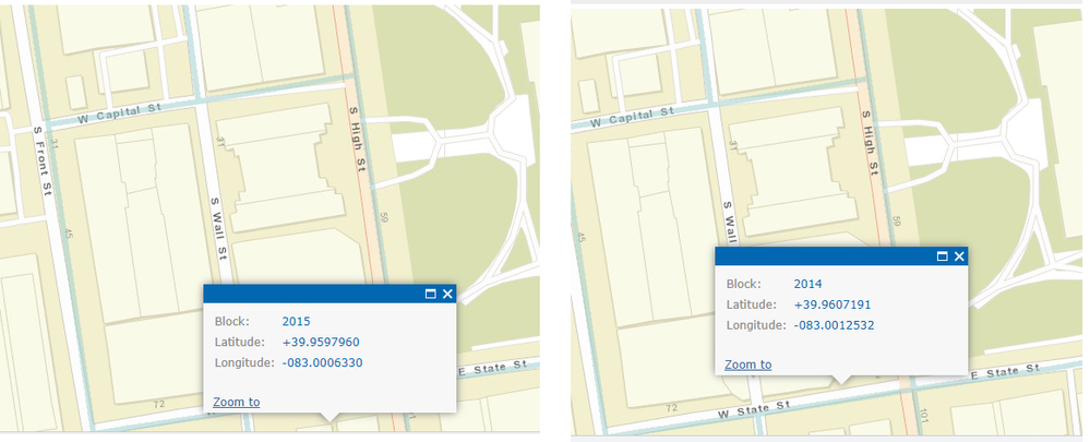

ChitraKrishnan
@RobertScheitlin__GISP
I am clicking inside "S Wall St" (blue outlined block) in the screenshot below. I am getting two different block#s  2014 and 2015.
was my attached code sample correct in bringing the block details?
Thanks
Chitra

              visible: true,
              label: "Block: "
              fieldName: "CENTLAT",
              visible: true,
              label: "Latitude: "
              fieldName: "CENTLON",
              visible: true,
              label: "Longitude: "
      GL = new GraphicsLayer({id: 'mygl', infoTemplate: popupTemplate});
      map.addLayer(GL);
      var arrayFromDatabase = [[-83.0014423,39.9593239],[-83.0006330,39.9597960],[-83.0019028,39.9617077]];
      queryBlocks(arrayFromDatabase);
      function queryBlocks(dbArr) {
        var q = new Query();
        q.outSpatialReference = new SpatialReference(102100);
        q.returnGeometry = true;
        q.outFields = ["*"];
        var qt = new QueryTask("https://tigerweb.geo.census.gov/arcgis/rest/services/TIGERweb/Tracts_Blocks/MapServer/2");
        dbArr.map(function (pntData){
          var pnt = new Point(pntData);
          q.geometry = pnt;
          qt.execute(q, function (result) {
            result.features.map(function (f) {
              var randomColor = '#' + Math.floor(Math.random() * 16777215).toString(16);
              var color = new Color(randomColor);
              color.a = 0.5;
              var gra = f.clone();
              console.info(gra.attributes);
              gra.setSymbol(
                new SimpleFillSymbol(SimpleFillSymbol.STYLE_SOLID,
                  new SimpleLineSymbol(SimpleLineSymbol.STYLE_SOLID, new Color([0,0,0]), 1),
                  color
              GL.add(gra);
