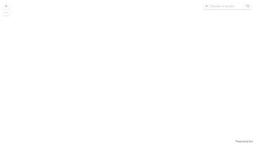

Are you using the search widget? If so, this should work just fine. Here is an example from the current version (4.24). Try out the Census Block Group locator, which searches on a esriFieldTypeDouble field.
https://codepen.io/noash/pen/qBYbMXd?editors=1000
