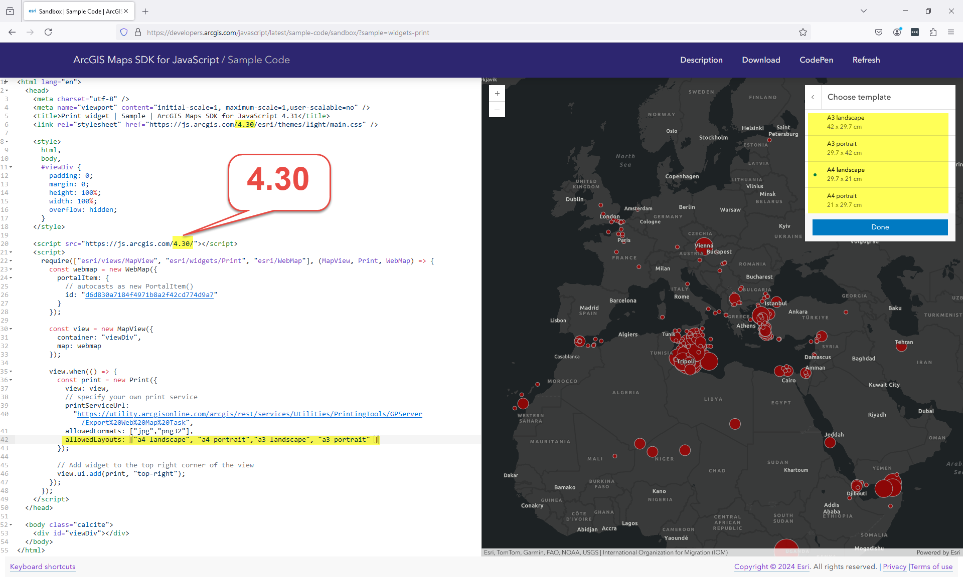

We have a custom app that was built using version 4.30 and includes the Print Widget.  The widget was configured to only allow the UK A4 and A3 paper sizes via the following code:
printServiceUrl:
"https://utility.arcgisonline.com/arcgis/rest/services/Utilities/PrintingTools/GPServer/Export%20Web%20Map%20Task",
allowedFormats: ["jpg","png32"],
allowedLayouts: ["a4-landscape", "a4-portrait","a3-landscape", "a3-portrait" ]

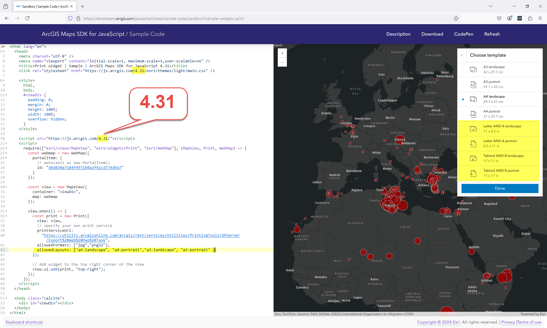

Since the upgrade to 4.31, the print widget now shows the two Letter and Tabloid paper sizes.
This isn't a problem with our custom app, because the exact same behaviour can be replicated in the Esri sandbox: https://developers.arcgis.com/javascript/latest/sample-code/sandbox/?sample=widgets-print
KathrynWalker
Hi @MappyIan,
We are aware of this behavior and have BUG-000172226 logged for this issue. Please reach out to Technical Support if you wish to be attached to the bug and follow along with its progress.
