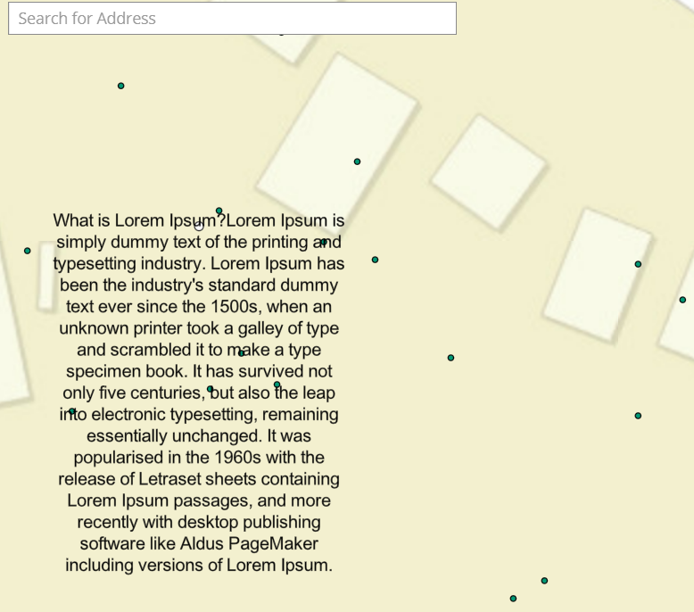

I'm using ArcGIS Javascript API 4.15 for a web application, I have a TextSymbol added on the map, when I try to print the map using PrintTask, it is not printing the text in the proper format.

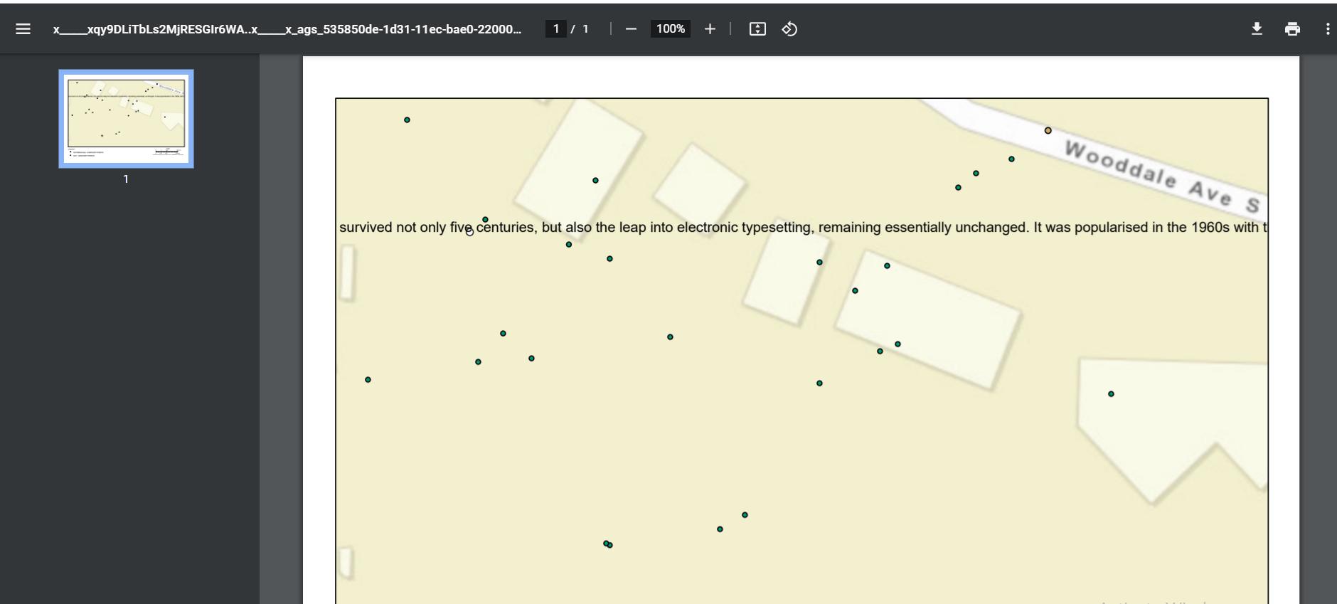

the above image is of the map with textsymbol, and the print version is this.
it prints all the text in a single line.

Thank you for reporting this issue @YashvitNaik. It looks like the lineWidth property is not being properly honored. We are currently investigating, and I will respond this post when we have an update to share.
As a workaround, if you manually add newline escapes ("\n") to the text, it will print better. Example (ignore the missing symbols as the Esri Icon Font is not installed on the print service server):

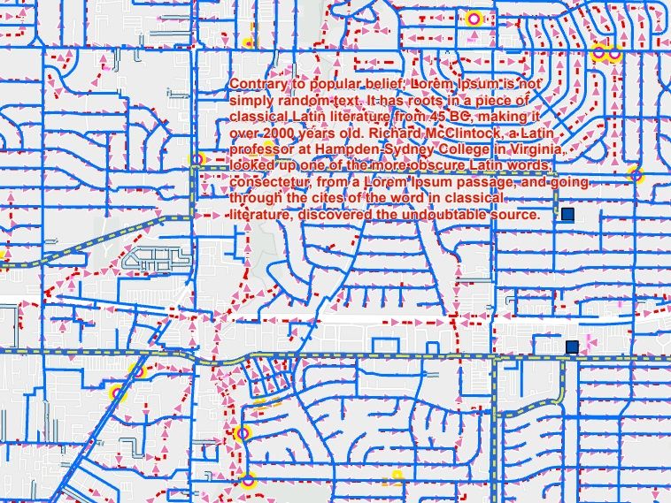

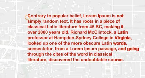

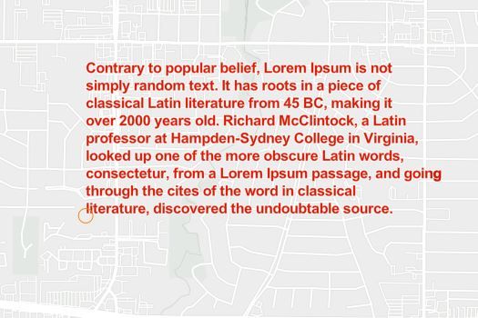

This is how it looks for verticalAlignment: "bottom"
Note the orange circle edit point which indicates the starting point for where I clicked to add the text.
This is how it looks if I accept the default verticalAlignment value of "baseline"
While the baseline setting is preferred, since it goes downward based on where you clicked and started your text, the problem is when our users go to export the map to pdf. They expect whatever is showing on the map, with all their redline markups and text, will be sent to another person and appear the same way. I am forced to make text start from the "bottom" only because it's reliable in the output pdf.
The result of printing the last image above, with "baseline" as the vertical alignment, will be the following.
I realize it's difficult to compare to the one above without the line and point features, but you can see the text shifted to way above the thick white (highway) line.
