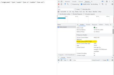

This seems really strange to me.  Are you still seeing the same error @LAProAg?  When I go to the URL provided I see the appropriate Access-Control-Allow-Origin header in the response. Is it possible something on your network like an application firewall, proxy or something else is overwriting the header and setting it to another value or removing the header all together in the response?  If you open the network tab in your browser and go to that url do you see a * for the Access-Control-Allow-Origin header value or something else? You also might want to try the request using and not using your corporate vpn and see if that makes any difference.
LAProAg
Hi @Sage_Wall Thank you for your reply. I really appreciate it. Accessing any js.arcgis.com URL directly  I also see the appropriate Access-Control-Allow-Origin header in the response. Even with localhost I dont see any CORS errors. Our application is deployed using AWS elastic beanstalk in linux ubuntu environment. Currently the application is only available through private subnet so can only be accessed via vpn. And yes still no luck resolving it.
