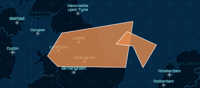

I click on the Quick Add button and then overlap the 2 polygons.  Then I click on the Merge button - hoping that the two overlapped polygons will join.
Sometimes I am left with one.  Sometimes all Polygons are removed.

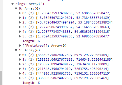

The coordinates that comeback from the GeometryEngine are spurious (line 121):

Interesting, I didn't know that sketch would default to the map SR, but that makes sense I think. Just something to keep in mind when using geometry engine methods. I should be a good practice anyway since it does require all geometries to be the same spatial reference.
You could use the webMercatorUtils module to help convert geographic and webMercator pretty easily.
graphicsLayer.graphics.map(function (gra) {
    if (gra.geometry.spatialReference.wkid === 4326) {
        updatedGeometry.push(
            webMercatorUtils.geographicToWebMercator(
                gra.geometry.clone()
    else {
        updatedGeometry.push(gra.geometry.clone());
const joinedPolygon = geometryEngine.union(updatedGeometry);

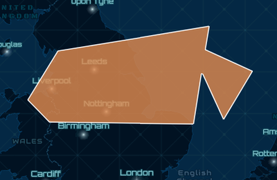

This is expected.
You might see some oddities because you are using a class instance to new up a new class, which you don't have to do
// don't need this
updatedGeometry.push(new Polygon(gra.geometry));
// can do this
updatedGeometry.push(gra.geometry);
// or this
But you have two polygons that do not overlap. So when they union, it becomes a polygon with multiple rings.
You don't need to iterate over the rings, the result of the geometryEngine union is a geometry, so you can use it directly.

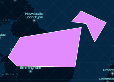

If you want the polygons to become a single polygon with a single ring, you can do something like convexHull
const [result] = geometryEngine.convexHull(updatedGeometry, true);
graphicsLayer.removeAll();
let resultgraphic = new Graphic({
    geometry: result,
    symbol: mergeSymbol
graphicsLayer.add(resultgraphic);
demo: https://codepen.io/odoe/pen/ZEoMLmj

PaulAnderson2k
After further debugging...
When one of the polygons is clicked, I noticed the following changes in the graphicsLayer.graphics.items.
Here the wkid changes for Polygon 1 after clicking on it using the mouse.  The ring coordinates change along with the spatial reference.
 After Quick Add Intersect Button ClickAfter Click On Polygon x

PaulAnderson2k
I am thinking the problem is the base map spatial references.  I am not sure what the correct solution is here.  Help!
I am believe I am using WGS84 coordinates.  On closer inspection the base map has a spaitalReference.wkid of 102100 which refers to WGS_1984_Web_Mercator_Auxiliary_Sphere (WKID 3857).
Spatial references | Documentation | ArcGIS Developers
SpatialReference | API Reference | ArcGIS API for JavaScript 4.24 | ArcGIS Developers
FAQ: Why does ArcGIS Online use a deprecated spatial reference (102100) for hosted services? (esri.c...
Using spatial references—ArcGIS REST APIs | ArcGIS Developers
Solved: SketchViewModel New Point Bug? - Esri Community
I was hoping to use coordinates using  standard latitude/longitude with 4326 where we would store coordinates outside of arcis.
From Spatial references | Documentation | ArcGIS Developers
4326 - GPS
4326 is the most common spatial reference for storing a referencing data across the entire world. It serves as the default for both the PostGIS spatial database and the GeoJSON standard. It is also used by default in most web mapping libraries.
Because of its use in GPS, 4326 is generally assumed to be the spatial reference when talking about "latitude" or "longitude".
3857 - Web Mercator
The Web Mercator coordinate reference system is the default in most web mapping libraries. Web Mercator preserves a consistent direction and North is always "up" on a Web Mercator map. Angles are also depicted accurately, so a 90-degree turn on a Web Mercator map will look like a true right angle. That said, the projection can distort both shape and size as distance from the equator increases.
Web Mercator is ideal for generating map tiles, since it projects the world onto a square tile that can be subdivided evenly across all zoom levels. For example, one tile at zoom level 0, four tiles at zoom level 1, and so on.
ReneRubalcava
Esri Frequent Contributor
    else {
That should do it.
https://codepen.io/odoe/pen/oNdPKNv?editors=0010
