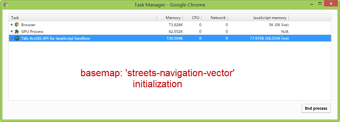

I'm working with the map of 'streets-navigation-vector', and I found that the javascript memory will be increased after map zoom in and zoom out.
I tried to test the demo and the problem still exist.
the url of demo:
ArcGIS API for JavaScript Sandbox
the status of javascript memory in google chrome

  I accept the process of zoom in and the process of  zoom out. I'm confused that the memory is not the same after zoom in and zoom out. The memory shouldn't be the same for the same center and same zoom level?
  If the memory keep increasing during zoom operation (for vector tiles basemap), the browser will be crashed in the end.  It's terrible.  Is it a bug to the vector basemap or how to avoid it if use the custom vector tiled map?

   So are you saying that you are seeing the memory consumption continually grow? 89K to 92K is not any kind of an issue for modern computers.
