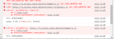

just realizing.... In my actual application, I use the require () dojo syntax. I get an error (image added below) when I try and load the chart.js zoom plugin in the same manner (using dojoConfig) as the full Chart.js library, as noted in the blog post - https://community.esri.com/t5/esri-technical-support-blog/using-third-party-graphing-libraries-with-...
here's the dojoConfig and I also add the zoom plug in to the require array.
      const options = {
          // tell Dojo where to load other packages
          dojoConfig: {
              async: true,
          packages: [
              //      location: 'https://cdnjs.cloudflare.com/ajax/libs/hammer.js/2.0.8/hammer.js',
              //      name: 'Hammr'
here's the error -

Solved!!
Apparently, using a blog post from 2018 as an example is not a good idea.
I removed the dojoLoader part and the additions to the require array, then added the Chart.js and the zoom plugin using traditional script tags and it all works now!
