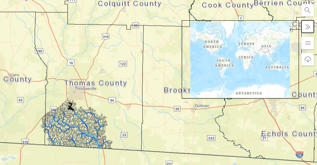

I have created an overview map widget for my web app. I am using the `arcGIS API for Javascript` version 4.17. My overview map is separate from my main map as I don't want to bring in all the layers from my main map in the overview. I have basically followed the API documentation as a guide

I then create some code to `sync` the overview map zoo, center, and scale to the main view map. However, this does not work.

Essentially, the overview map is not syncing with the main map and doesn't pan or zoom with it after launch. Any ideas as to what I am doing wrong here?
