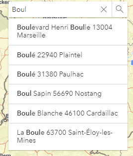

I have a question regarding in esri arcGIS search widget. How to modify the search suggestionResult? this is the current design for the suggestResult
what i mean in modifying the suggestResult is, add html file

ReneRubalcava
Esri Frequent Contributor
You can do this with a custom source where you override the "getSuggestions()" method.
https://codepen.io/odoe/pen/oNGGZpY?editors=1000
return results.data.features.map((feature) => {
    return {
        key: "name",
        // HTML in return text
        text: `<span class="my-suggest"><i>${feature.properties.label}</i></span>`,
        sourceIndex: params.sourceIndex
