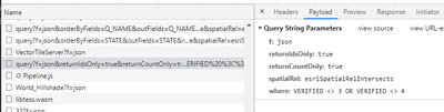

When I open the network request, it displays
I have the definitionExpression set to this so it will ignore any record that has a 3 or 4 in the verified column, yet when I query, records with 3 and 4 continue to be displayed.
definitionExpression: "VERIFIED <> 3 OR VERIFIED <> 4",
the network request displays:
luckachi

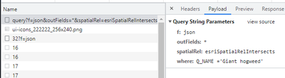

When I initially load the map however, I see this.
so it seems like the params.where line for each additional query isn't retaining that information?
