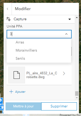

I have a problem with the Editor Widget on Arcgis JS Api 4.24 (and 4.25) .
Using the editor, I try to filter a field that has coded values on it.
The problem I'm having is that I can't filter the values of the field.
The field seems to be filtered only on the keys of the coded values, not the labels.

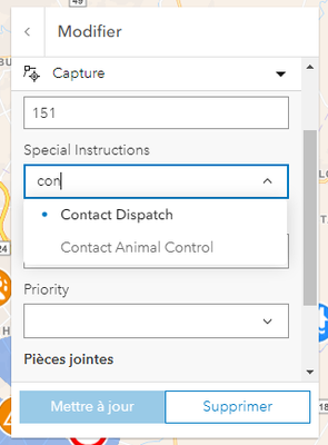

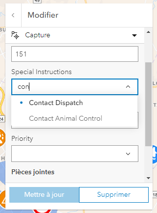

In the example proposed in the documentation (https://developers.arcgis.com/javascript/latest/sample-code/widgets-editor-basic/), the features of the layer have fields with coded values whose key and value are identical.
So when I filter the field, it works as expected:

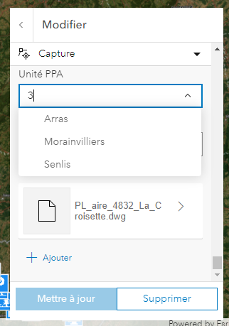

For my part, this is not the case. My coded values keys are integers and different from their string values :
Because of this, I can filter the field by the coded values keys but not the label (the input doesn't let me type letters).
Is there a way for me to filter the values on the labels ?
Thanks.
JB19
It seems that I misunderstood the reason of the issue.
These two fields are quite similar, but one of them is `esriFieldTypeSmallInteger`.
Because of that, the search input of the field's combobox is not accepting letters.
It means that the user cannot search a value in the comcobox by its name, which is quite strange.
