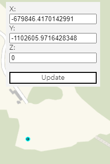

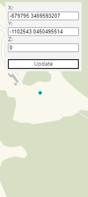

So far I managed to register the update event on the sketchViewModel and if that was in state of start or active to grap the geometry first extract its current coordinates X, Y, Z to my input fields. Then user can modify the values and use "Update" button. The update function modifies the event geometry passing input values into geometry.x, .y and .z coordinates. So far this works and if I log the values they are changed. The problem is, that the map does not "refresh", meaning the point does not move. Saving the editation or manually moving the point with cursor "teleports" the point to the corect location. I hope it is visible in these two screenshots.
Point with it's coordinates.
click and hold on the same point after coordinates have been changed. Barely visible, but coordinates are different.
