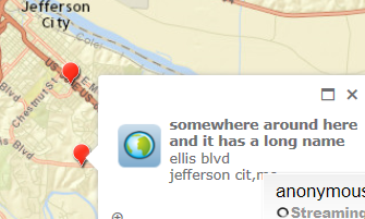

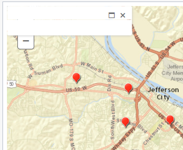

Thank you!  Once again, I'm getting some funky behavior in IE.  The first time it positioned the infoWindow in the far upper left.
Then I clicked this one and it worked:
Then I clicked the red pin just about it - and it drew this same infoWindow again in the same place as 'somewhere around here'.
After that, it started working correctly.
Looking at this in Chrome, you can see that the first feature you clicked sort of flashes an infoWindow in the upper right before it places it correctly.
