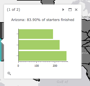

Setting the title to null works to remove the title from the header in my testing.  Another option could be to set the titleInBody property of the popup to true. This property adds the title to the popup content instead of the title area.
Also if you want to avoid the header look try  using one of the built in themes available for the popup. There are two themes light and dark. Here's an example of how the light theme looks when the title is set to null.
Here's a jsbin that shows the code that produces the above info window:
JS Bin - Collaborative JavaScript Debugging
I've also attached the code file.
