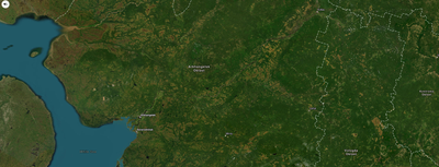

this is the example:
I click on the compass but nothing happens, any idea why?
