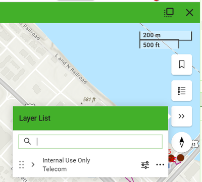

I would like to change the header background to match our UI:
The problem I am running into is:

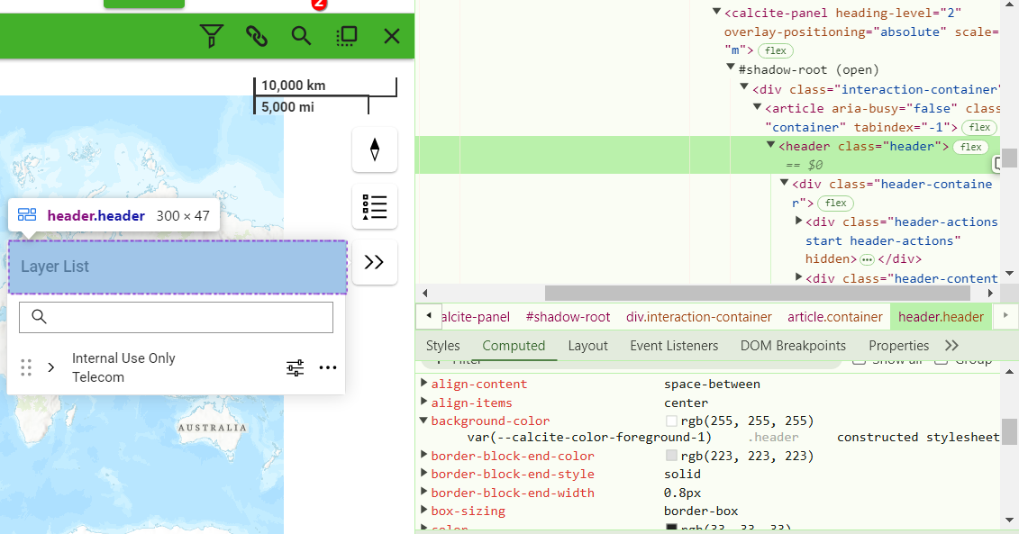

1. header is inside the shadowDom so I can't directly style this through CSS
2. The var used for the header background is the same var used for the entire background
I would like it to look like this:

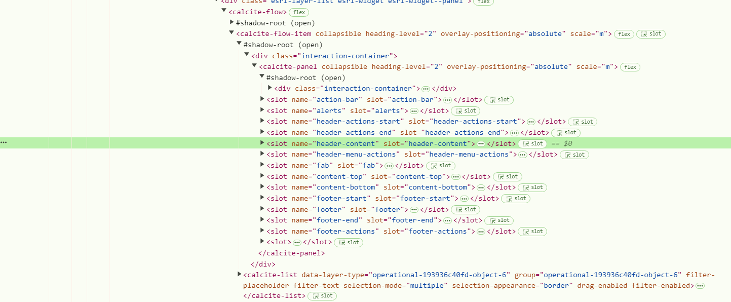

Here is the header slot nested in several shadow-doms that I cannot penetrate with CSS:

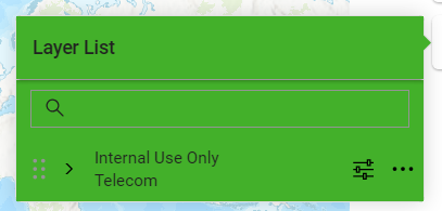

And setting the var --calcite-color-foreground-1 to green gives me this:

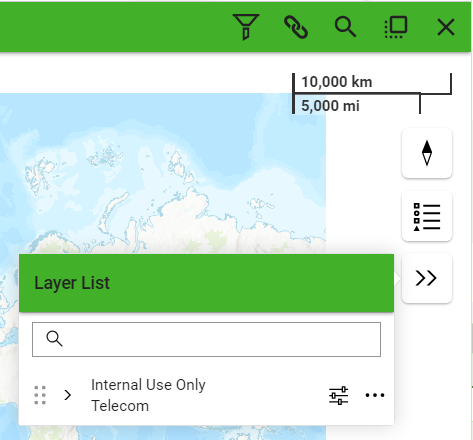

Sage_Wall
@ColleenDixon I made a mistake.  That first solution will work next release at 4.32.  This is a less elegant solution that would work at 4.31
https://codepen.io/sagewall/pen/MYgKaqo
Sage_Wall
Hi @ColleenDixon with the introduction of web components into the API situations like these are becoming more common.  I came up with this solution but it may have other unintended consequences ( or maybe they will be happy surprises ) because it changes the background color for all calcite-flow elements. Thanks for bringing this up hopefully we can improve the ability to style things in the future.
https://codepen.io/sagewall/pen/raBxOLy
Sage_Wall
ColleenDixon
That worked for me, thank you!
Did have some unintended consequences a few other places like the info window but I can try and work around those
