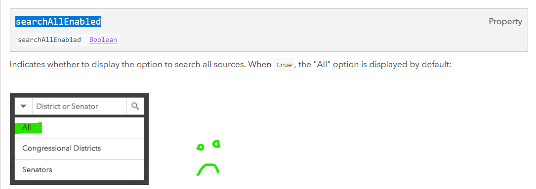

Good morning,
I would like to change the default All that appears with the SearchAllEnabled option to a custom one, as it is badly translated into Italian
current "All" ---> "Tutte le" (all the)
in this case the correct ways is "All" ---> "Tutto" or "Tutti"
but I could not find an option
thank you all in advance

The translation of this label, for the Italian locale, comes from this file @ArcGIS\core\assets\esri\widgets\Search\t9n\Search_it.json.
You may want to change it there yourself, or you could ask the ArcGIS JS Development team to modify the translation.

Thank you, I made a copy of the file with the correction that will replace the incorrect one after the build
