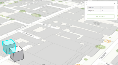

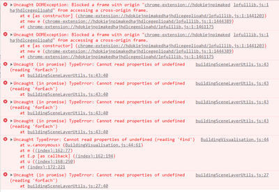

By unrepsonsive I mean the floor filter is not showing any specifc floor but staying at the slide view (floor by floor slide) of the section. The only change I made to the code is just change the ArcGIS Online organization link and the item ID of my scene having the building layer. So I think there must be something different in my building layer to the Turanga Library example. I open the f12 inspector and found all these error messages with my web scene while no error message is reported with the example:

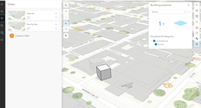

To simplify the issue, I go further and create a very simple feature dataset with just one feature class called house containg 2 multipacthes. The only attribute inside is just BldgLevel. I then make it as building layer, publish it and view it inside the scene viewer with building explorer and has no issue.
I then put it inside the building view by updating the item ID in the  config.txs. These are the error message I have.
