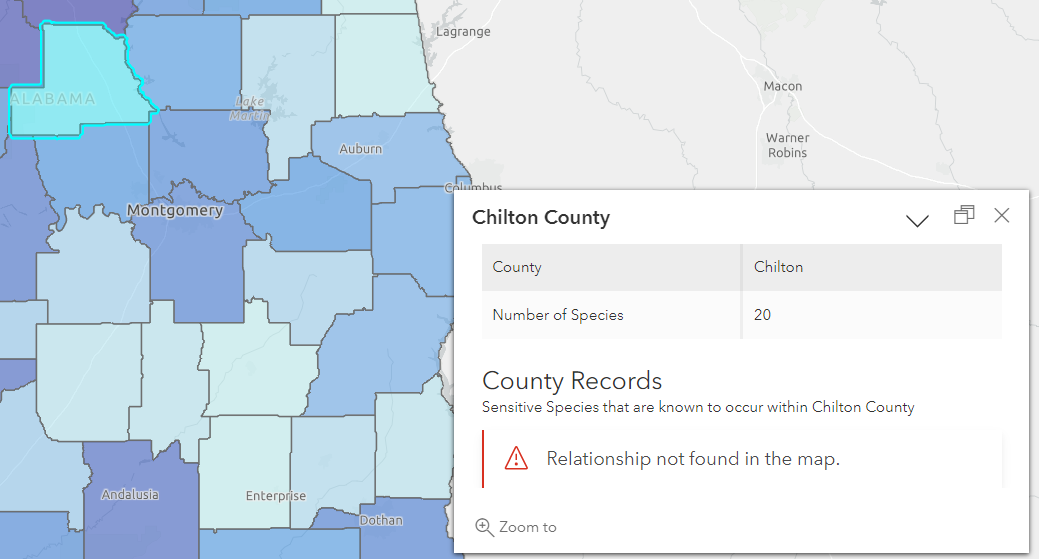

Everything loads into my map fine, except when I click a county for the pop up, I get this error.

This is my call to load layer/table into the map. This occurs directly beneath the last const to bring in the table. At first, it wasn't working when I realized these layers were a "MapServer" and not a "FeatureServer" in the sample. So we were able to publish my layer/table as a "FeatureServer", but it's still not loading my relationships. Is there a limitation at this point I'm not aware of? In my fields, I'm naming the fields as they are in the data but not their alias, but not sure that's the issue.  Any help with this would be greatly appreciated.

Hi @Rice_GIS -
Browsing related records within a popup is only supported for ArcGIS Online hosted feature services at the moment. This limitation is outlined in the RelationshipContent API documentation. We plan to support ArcGIS Enterprise services in a future release.
