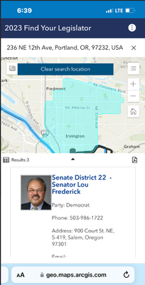

@KellyHutchins I'm having a similar but different issue. When I enter 236 NE 12th Ave, Portland, OR, 97232, USA  in this app https://geo.maps.arcgis.com/apps/instant/lookup/index.html?appid=fd070b56c975456ea2a25f7e3f4289d1 the right results show in the map (though there is a "phantom" selected feature) but the wrong results show in the results panel.
It doesn't matter whether I select the result from the dropdown list. I checked the app JSON as you suggested in the solution to the other post and I think it looks correct.

I just ran a quick test and get SD 21, HD 42 and CD 1 which looks correct based on the map. Are those the expected results?
ArielLow2146
Thanks for running the test! Those are the correct results and I'm not able to reproduce the issue anymore either.
