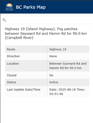

I noticed that the Pop-ups on the new Basic (Media Map) do not work well in mobile. The positioning of the pop-ups is off as the pop-up title, dock, collapse, and close button/icons are cut-off from view. It also overlaps with other widget elements as well. Our map is here if you want to take a look.

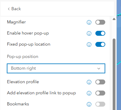

Hi @RexTurgano
In the Instant App configuration have you looked into the following settings or tried floating pop ups instead of docking them? The fixed pop up location on its own when looking at the view in Portrait mode looks better.
Reduce header height or make it collapsible. The static header may be pushing the pop-up off-screen. Consider:
• Reducing the header height.
• Making it collapsible or using a splash screen for intro content.
• Moving disclaimers or long text into a modal or info panel.
I hope this helps somewhat.

Hi Kelly, I just had the chance to implement the CSS and the pop-up displays in full but there is now "x" or option to close the pop-up.
