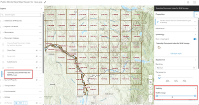

Here is a screenshot of my web app viewer classic township layer:
The visibility range:
In the new map viewer, visibility range:

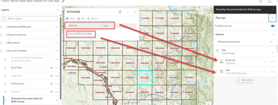

New map viewer pop-up window: (one field list and one text arcade script, (I'm still working on the script)

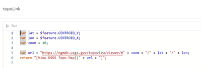

Currently this is the arcade script for the text field but I'm still tweaking it.
