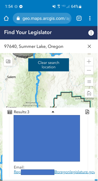

I'm having an issue where on a mobile device the email address is getting cut off. The mobile device is a Samsung Galaxy and the browser is Chrome.
This is happening in a Zone Lookup App and seems to only be happening with the email, other text appears to flow to the next line correctly. The source HTML from the pop-up text element is as follows:
<p>
<span style="color:#9E6900;font-size:18px;"><strong>OR House District {DISTRICT} - {Name}&nbsp;</strong></span>
</p>
<p>
Party: {Party}&nbsp;
</p>
<p>
Phone: {Phone}&nbsp;
</p>
<p>
Address: {Address}&nbsp;
</p>
<p>
Email: <a href="mailto:{Email}" rel="nofollow ugc">{Email}</a>
</p>
<p>
<a href="{URL}" rel="nofollow ugc">Website</a>
</p>

You can add a scroll to accommodate longer content with the below custom CSS.  An issue has been logged to add a scroll by default, this will be included in the next update of ArcGIS Online.
.esri-feature-content{
overflow:scroll;

ArielLow2146
Thanks @BethRomero! Excited to hear that this will be included by default in the future.
One other solution which was suggested by one of my colleagues was the following CSS:
.esri-feature-content a {
    word-break: break-word;
