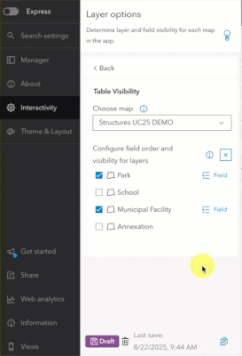

Within the Manager App, where do you configure the visibility and order of fields showing in the table view?
SarahMcDonald_Esri
Hi @ACrateau
You can adjust the fields order/visibility in the web map using Map Viewer or you can use the layer options in the Manager configuration. If you go to the Interactivity section > Layer options > You can select the layer you want to adjust the fields for.

ACrateau
Thank you, Sarah!  The Layer Options in the app worked perfectly.
