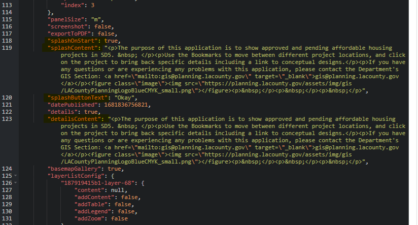

Having this issue with the Sidebar Instant app configuration. I actually decided to add line items to the JSON via AGOL Assist to get the intro panel added / updated. It was an issue with both the Splash Screen content and Details item content. Below is a screenshot of the items I had to add to the JSON.
Happens with new or existing apps in our organization (LA County).
