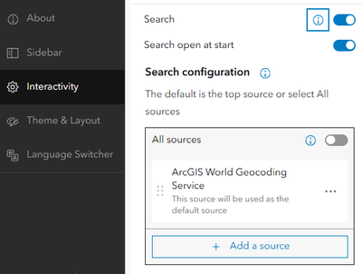

I have not use the nearby app, but in the apps I have tried you can customize some search settings. Turn off express mode and go to interactivity>Search. Select the ellipsis beside your geocoding source and then expand additional search options. This should show a scale bar to you can set to your desired scale. It may look a bit different for your app but from my experience there is some sort of function like this. Hope that helps!
HWhitty
Thank you for this suggestion, @SarahShermack . I followed your instructions. The zoom scale was set to Streets by default. I changed it a few times to City, Town, etc., but still the map wouldn't zoom upon searching. Thanks anyway!
