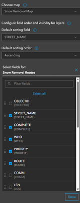

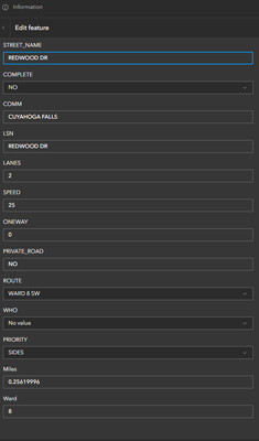

I have a Manager instant app that is used for editing a layer. I have a configured pop up for the initial selection. Then when "edit" is clicked, it is supposed to only show the fields that I have checked in the Layer Visibility section of Modify. However, it shows all of them still.
I have an identical manager instant app but for a different map. It works as it should. I am not sure why this one won't. Below are screenshots of my selection.
Any help is appreciated.

Hi @CamTurney_CityofCF
The fields that are visible in the Edit window are driven by the form. You can author a form for your webmap using Map Viewer or Field Maps Designer. In the form builder you can choose which fields to display, place them in order, and more. If you haven't created a form, then a list of the editable fields is displayed by default.
