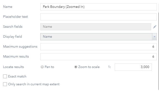

The search widget in my app isn't working for the fields with a domain.  It works for all the other fields that I've tried.  I've tried making a completely new search widget and hosted the data multiple times as both map images and feature layers, but nothing is working.  Do y'all have any clue what might be going on?
Thank you so much!
Update!
So apparently Domain fields do work, you just have to type in the full, exact name for the search widget to find it.   I don't know why this is.  Does anyone know what might be going on?  We need it to be able to guess what people are typing, because some of these places, no one knows how to spell.  Here is how I have it set up:
