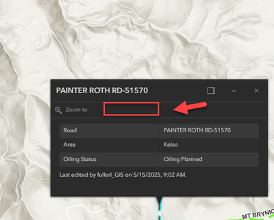

My edit widget was working yesterday in my sidebar instant app.
After last nights update to AGOL (6/25/25), my edit widget is no longer working.
The select button is missing in the edit widget, and the edit button in the pop-up window is missing too.

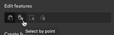

I noticed the "select" button is gone from the Edit widget. But I can edit using the select by lasso or rectangle. So maybe this is a design change and not a bug?
The edit button in the pop-up window is now missing thought, and that seems like it would be a bug and not a design change?

Thanks for getting back. Yes, the select button has been replaced with the multiple selection tools. These are new as of this release. If you use the icon next to the hand icon that will act like the select button used to.
We are looking into the missing edit button on the pop-up now. Will respond back once we have more information.

Hi @L77
This has been resolved. The edit button in the pop-up should be there now. Let me know if you are still seeing any issues with that.
Thanks!
Sarah
L77
@SarahMcDonald_Esri The edit button is back and it is working great, thank you!
