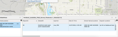

We have a map with one layer with the filter "CreationDate in the last week".  I created a web app using the Attachment Viewer and it's showing attachments for features not on the map.  I need the Attachment Viewer to show only attachments that make it through the filter.  How to do?  In the attached screenshot notice how there is only one point drawn yet Locations are 1/35.

In the second image above the pop-up is on the main feature -- not related.

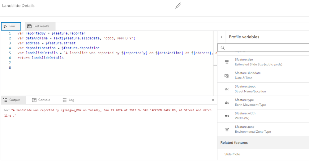

I finally made it back to this.  I went through the materials above and am now editing the Arcade, but I'm still not sure how to get Attachment Viewer to point back to the main record and not the Related feature.ArcadeForLandslide.PNG
There are only two features in the current filter yet the Attachment Viewer is showing four attachments.  It should show two features.
