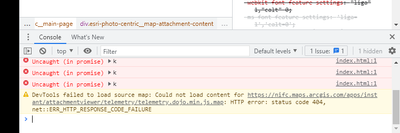

Also, if you open the developer tools in your browser, do you see any errors in the console?
SFM_TravisBott
I will send item id as a message.
And yes there was an error in DevTools: failed to load Web Map.
