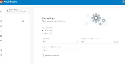

The Desktop version of Insights apparently has LOG files.  Anyone know where they are stored.
I am trying to debug a problem where I can create a workbook but cannot enter/edit the workbook.

Here:
%appdata%\Esri\ArcGIS Insights\logs
