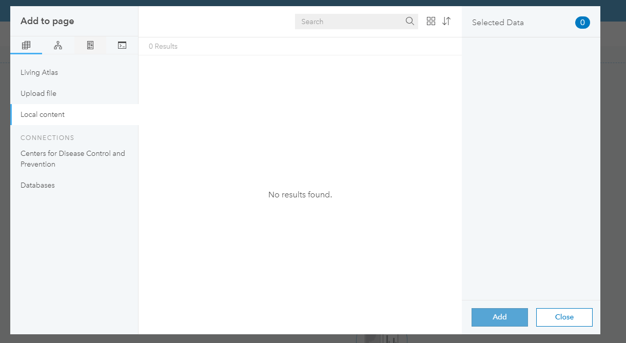

I hope you all are enjoying the virtual UC.  I just downloaded and installed the Insights Desktop.  I need to use the desktop version because of personally identifiable information (PII) that is not allowed on our ArcGIS Online organization system.  There is a option shown to add local content but I'm completely befuddled on how to add local content.  The Add button is not available.     Any tips?

To add data "locally" in desktop, you need to get out of the workbook and go to the home page.  In the datasets section.  There is a button "New Dataset" which acts in a similar way to "Add Data" but instead of adding it to a workbook, it adds it to Insights data so it can be added to multiple workbooks.  Insights home page to add adata

Hi Linda,
Thank you very much. That worked. Closing out of the application and reopening, came be a different interface where I found the Add Data button. I guess I was previously in a Workbook and didn't know it.
