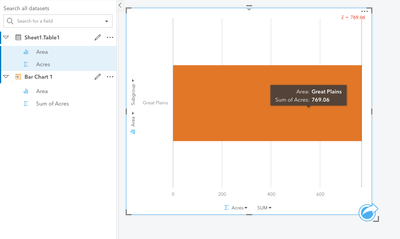

So, what I would like to be able to do I create a bar chart that would show 'Great Plains on the x-axis, and the column would show 769.06‬ (the sum of the acres). Please let me know if there is any other screenshots you would like.
Scott_Aulen
Is the {Acres} field type a Number? If so you should be able to drag to a Bar Chart and get the following.
SaraHedrick1
It is a number. That was the issue though, in the table the field type for this column was 'Text' and not a numeric data type. I made a new field for this column that had a numeric data type and I was able to make the calculations that I wanted.
