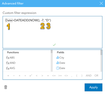

Good question. This can actually be accomplished currently using the Advanced Filter tool and Insights built in functions.
Example:
If I wanted to show records within the last 7 days I can create a query which includes dates that are greater than today minus 7 days using the DATEADD and NOW functions.
1. Replace with your date field
2. Replace with your last XX query (hours, days, months)
3. Replace with the corresponding unit ("h", "D", "M")

I tried this and it absolutely worked. Thank you!
