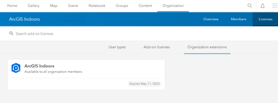

The license expired message shows up when the Indoors subscription license has expired on your Online organization. You can check the status of your subscription from the Licenses > Organization extensions in your Online account. I have attached a screenshot below. Please get the license renewed and try configuring the Space Planner app. Let us know if you have any other questions.

Hi,
I've already checked, the Indoors extension license is OK on our instance.
I've joined the screenshot.

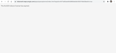

Can you also share a screenshot of the space planner app with the error?

Gaëtan_Lavenu
This message appears when I create a new Space Planner app or when I try to click on "Configure App" button on an existing one.
If needed, we can continue our discussion via email, I can also provide you a test account on our instance for testing purposes.
