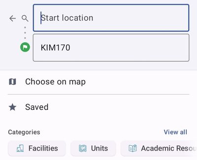

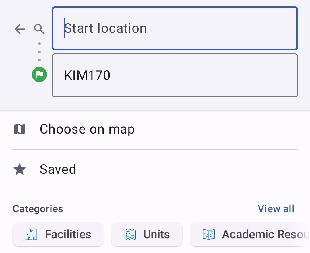

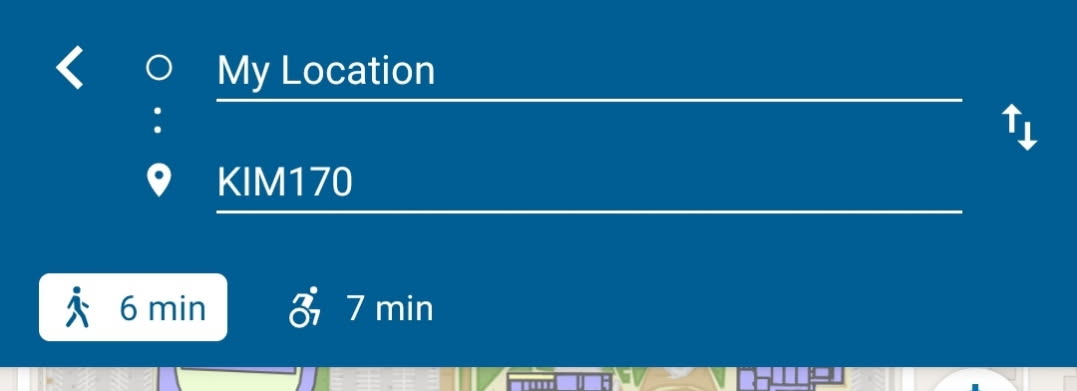

We're working on implementing the new ArcGIS Indoors Mobile app, but I'm unsure how to set it up to automatically provide the user’s current GPS coordinates as the starting location when they arrive on campus. In the older version, it would offer "My Location" as the default starting point. With the new app, it looks like users need to manually tap their location on the map, but visitors to campus aren't going to know where they are.
Is there a configuration option I am overlooking?
Classic - Autoloads with My LocationNew - No option for My Location
