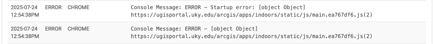

Hello, this might be super specific, but I have an Indoor Viewer app that we are trying to get loaded onto a kiosk in one of our buildings. The app seems to work fine in browsers. Our kiosks use different "players" for a system called Korbyt, and the app seems not to be loading on players that are KDA-Virgo. Hard to explain, but what happens is when the app is loaded, the map loads for a split second, then where the map should be, is just white space. The rest of the app loads, buttons, categories, routing capabilities, etc, just not the map itself. When given the logs from the device, it looks like it mainly just says it can't load the layers, and then also gives a message saying "Startup error: [object object] and then references a js file. I have attached images of the logs and messages. Also, the app displays the message about rotating the device to landscape mode, but the screen it is loading on is already landscape, and the app itself is definitely wider than it is taller, so it should be landscape.
The errors in the device logs don't match any server logs from our Portal so it looks like it is specific to the device. Does anyone have any ideas on what is happening?

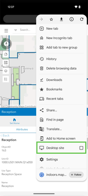

Hello @MollyE, thanks for sharing observations from your deployment. Can you share some details about the one kiosk device where the app doesn't work as you wish? Maybe the details below could be relevant.
Hello @KevinDohner, thanks for including details about the 'player'. I looked up KDA-Virgo (https://kb.korbyt.com/article/kda-virgo-players/). If that's the correct product, then I noticed that it runs Android OS and that could be one step towards resolving this issue. The next fact you mentioned about changing device orientation to landscape makes me more confident about my analysis.
Indoors Viewer is a responsive app and conforms to the form factor when opened on the browser of a mobile device. I have mostly seen large touch screen kiosks running Windows OS so the app (Viewer or Kiosk) opens just like it would on your work laptop/desktop however, if you open the apps on a browser on your mobile device then you will see a different layout (more suited for the smaller screen). From your message above, it seems that the app thinks it is being opened on an Android device even though it is not a mobile device but a 'player'. You will notice the same message if you open the Kiosk app URL on an Android mobile phone browser. One suggestion I can give you is to check if the browser in your player has a 'Request Desktop Site' option - all mobile browsers have it. If yes, then you can select it and see if there is any success. Eager to hear your response. Also, pls mention if you are on ArcGIS Online or Enterprise (which version).

That explanation makes sense and does explain some of the odd behavior, such as UI Elements and the Change Orientation message. I checked the specs on one of the other types of "players" that it does work on and it was using Windows as the OS. Unfortunately, that option doesn't exist on that player, or it is hidden to the user so the people in charge of the displays are going to reach out to the company and see what can be done. Thanks for the suggestion as I do think that is the issue.

Thanks for posting an update @KevinDohner. I've included a screenshot from an Android phone (Google Pixel 9) showing the option in the Chrome browser if it helps.

Wanted to provide an update and some info I have learned. So while the Android OS might've been an issue. I believe the actual issue I was having was the Browser Versions on the players themselves.
We were getting an error message in logs that was just saying "this._shaderModuleClass.inputs.findLast is not a function" coming from a mapViewDeps.js:983. After some researching, .findLast was a function introduced in ES2022 and therefore requires browser versions that for the most part, are newer than Jan 2022. I checked with the people in charge of the players and the Virgo players were running Chrome 94 when the min supported version for .findLast was Chrome 97. Unfortunately it sounds like the browser version can't be updated as it is managed via Korbyt (the company) and they don't update those players any longer.
We also ran into this issue with another kiosk with a different player. That player was running "QTWebEngine Based Browser 5 on Linux". Never heard of that but did find that the minimum version of QT that supports ES2022 was 6.14. We were able to update that player to Chromium 120. After updating the player, the kiosk app worked as intended.
